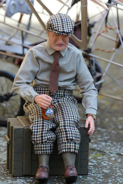

some news of progress
I remade the pulleys, changed these in plastic from shop by handmade with washer and ball bearing
new wheels with fake spoked for the first flight and training
and sculpting the pilot with Plastiline hard n°60
then changed the face...
after silicone
then plaster
after resin in the head, hand, foot and flexible foam inside
painting and sewing clothes - Pivo Zlatopramen 11° :lol:
That's all for the moment, but if you want to see all details and more, go on the page5 http://www.retroplane.net/nitra3/page5.htm
